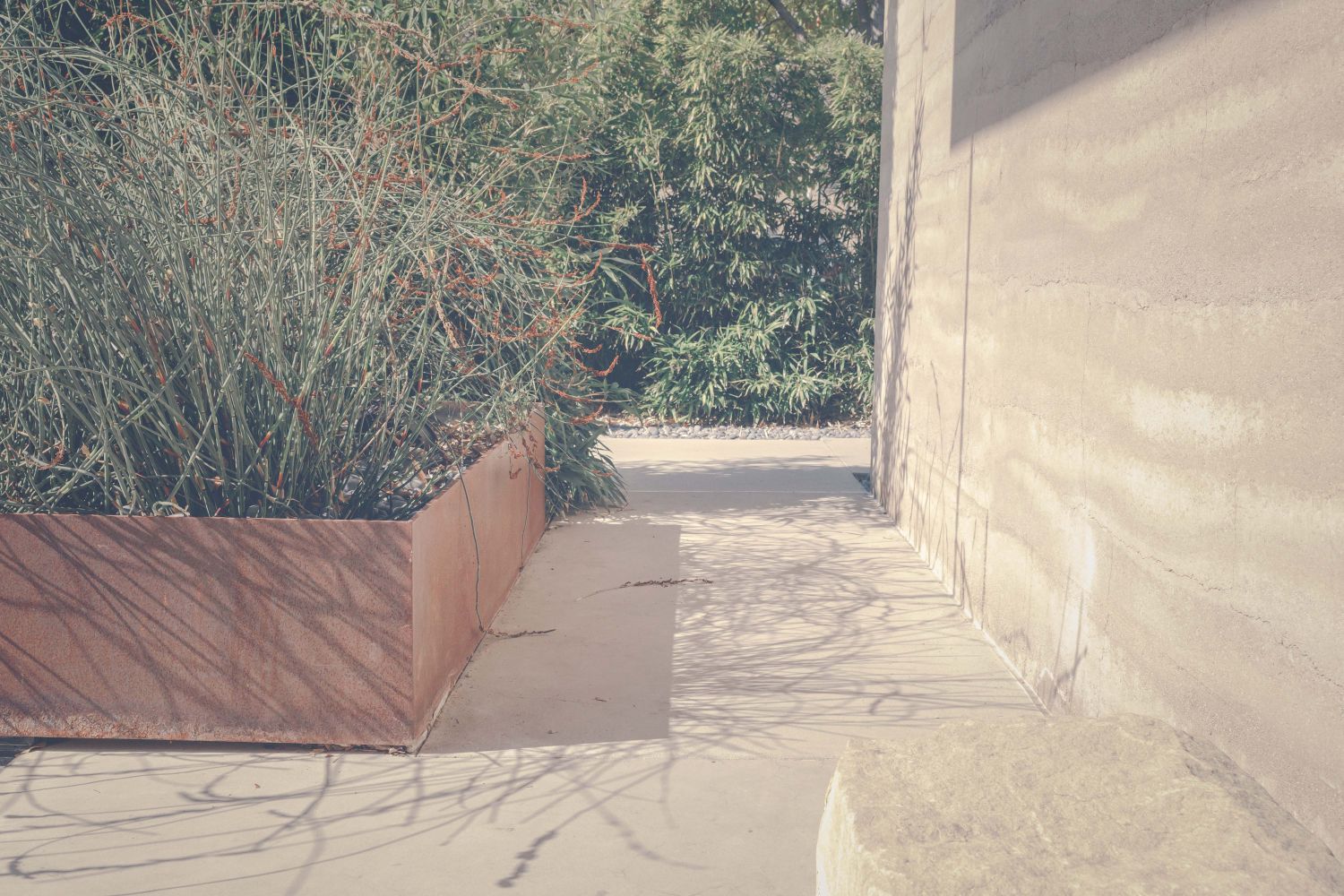

Architects value rammed earth for its natural, stratified texture that visually connects a building to its environment. Its tactile, earthen surfaces exude calm and permanence. As climate change and material shortages reshape construction priorities, rammed earth also fits the bill for regional, low-impact solutions. Without doubt - the growing demand for sustainable architecture has put this ancient technique back in the spotlight.
