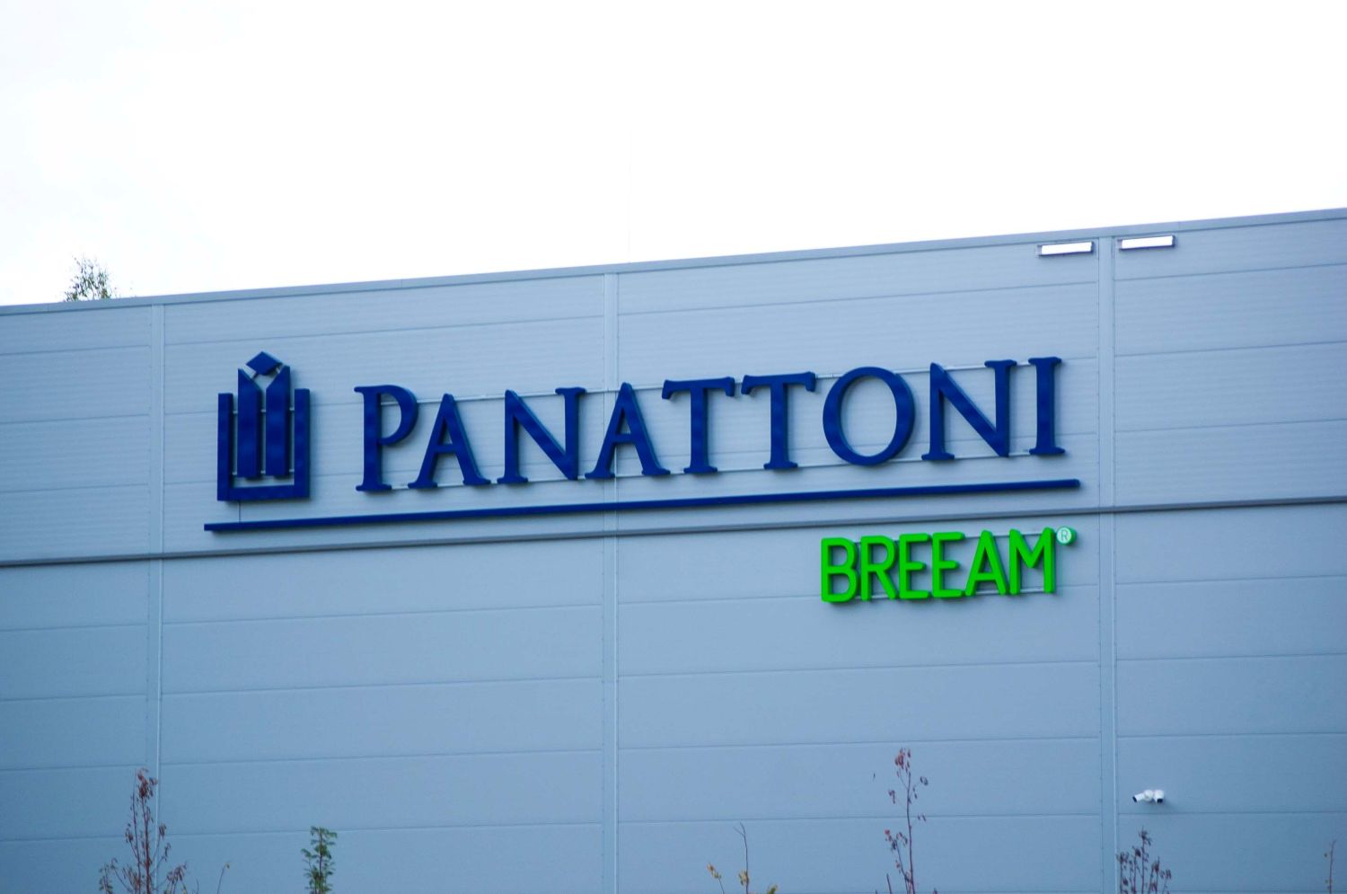

Walk into the reception of any new office block and you’ll usually see it, framed proudly behind the desk - a certificate, stating BREEAM Excellent or LEED Gold - sometimes Platinum, if the developer is feeling particularly pleased with themselves. The plaque signals virtue. It tells investors, tenants and planners that this is a responsible building. Sustainable, forward-thinking and best of all - certified. But here’s the uncomfortable question - do these certifications genuinely improve safety and sustainability - or are they simply the industry’s preferred way of proving that it has tried, writes John Ridgeway?
