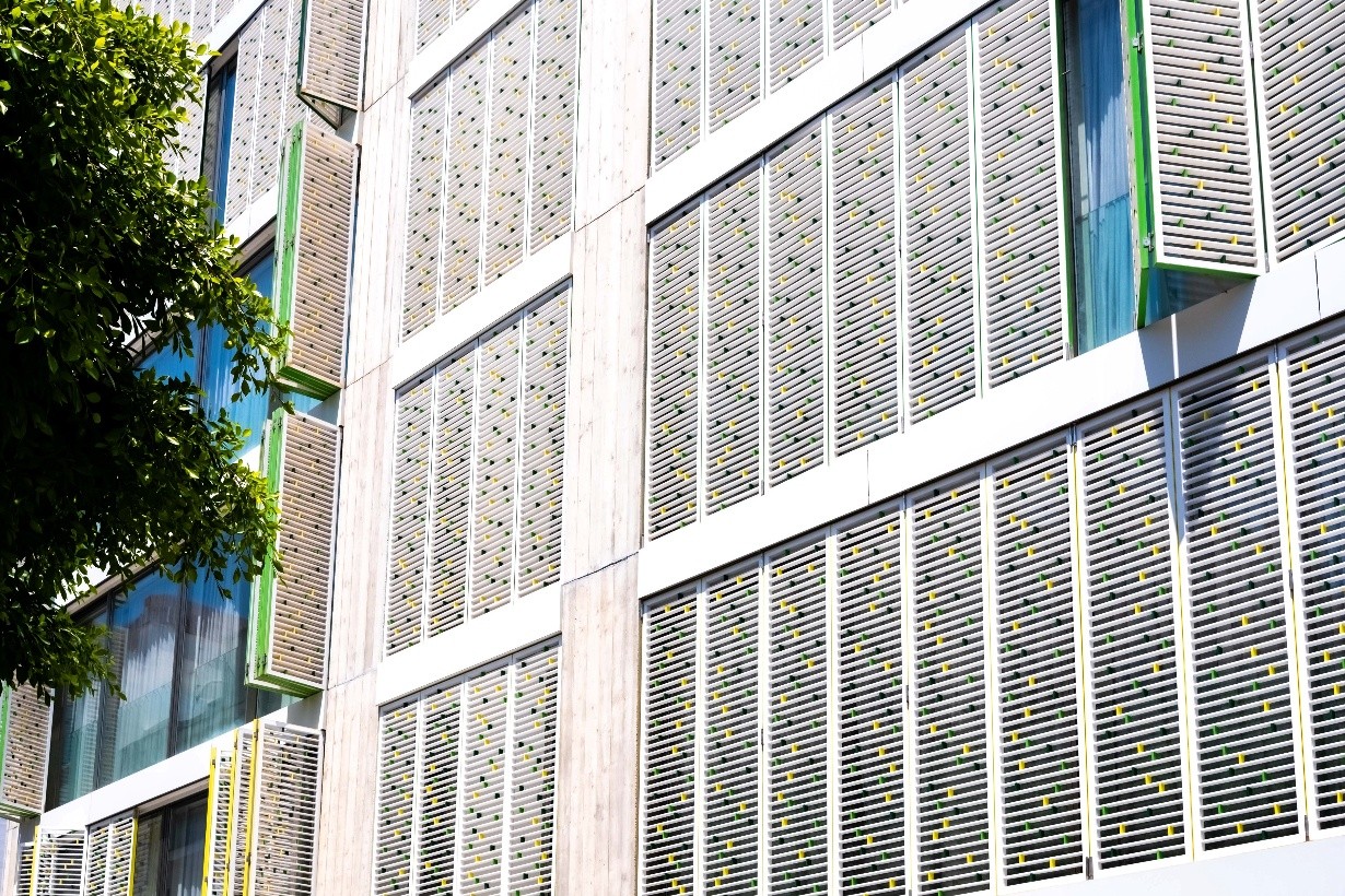

Modern homes are typically heavily insulated and incredibly airtight to retain winter heat, meaning west- and south-facing windows receiving excessive sunlight can quickly make these properties uncomfortable for occupants. External shading, such as vertical louvres, folding awnings or shutters should therefore be incorporated into the building design to block solar radiation before it is able to strike the glass. Furthermore, architects and designers should look to utilise brise-soleils or deep eaves and ensure glazing limits comply with Approved Document O.

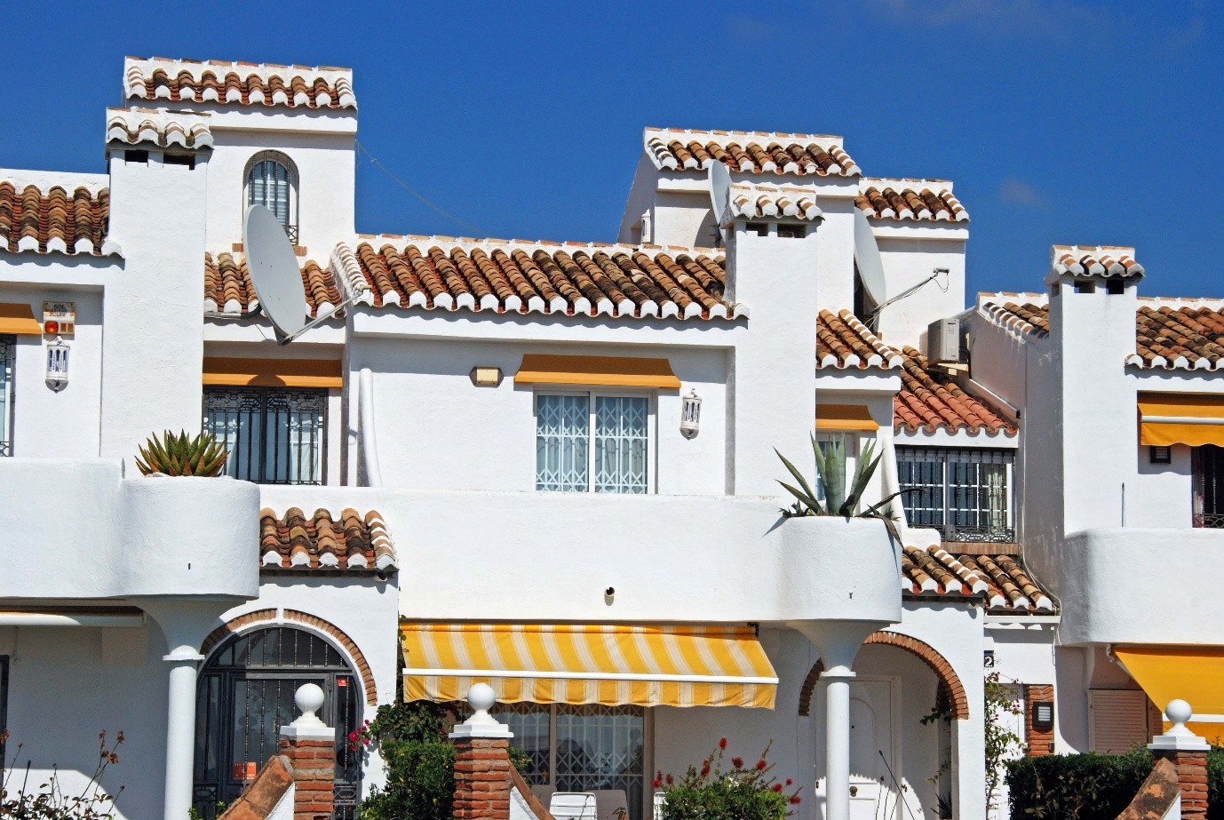

Most homes in Spain are built with a primary structure of reinforced concrete, floor slabs and steel pillars. With the exterior walls typically constructed using hollow concrete blocks or clay bricks that are then covered with thick stucco, these properties are far more effective at keeping interiors cool.
( Spanish style housing)
The concrete absorbs the heat during the hottest parts of the day, keeping internal spaces much cooler. At night, as the air cools down, the concrete radiates that heat back into the rooms.
