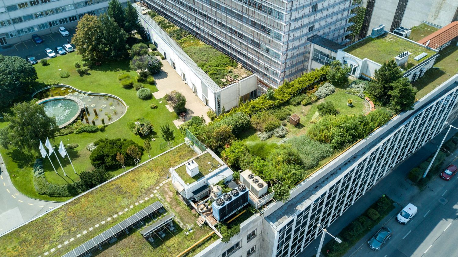

Another key issue is that plant is often being pushed out of view. Put simply, architects, planners, and clients don’t want to see bulky kit on rooftops. Instead, they prefer landscaped green roofs, PV panels, or roof terraces for residents. While they look great, they leave little or no space for mechanical plant. That pushes air source heat pumps downwards, often into basements or internal plant areas.
(Image above: a good example of services incorporated into a roof landscape)
However, air source heat pumps were never designed for that. They’re ideal for installation in open air, with clean airflow and free discharge. When they’re squeezed into enclosed basements, it doesn’t just increase the need for forced ventilation but also risks compromising lifespan and performance.
So, that puts everyone in a difficult position. The roof is off limits, the basement is overcrowded and the façade is the only place left to breathe – and it’s starting to show.

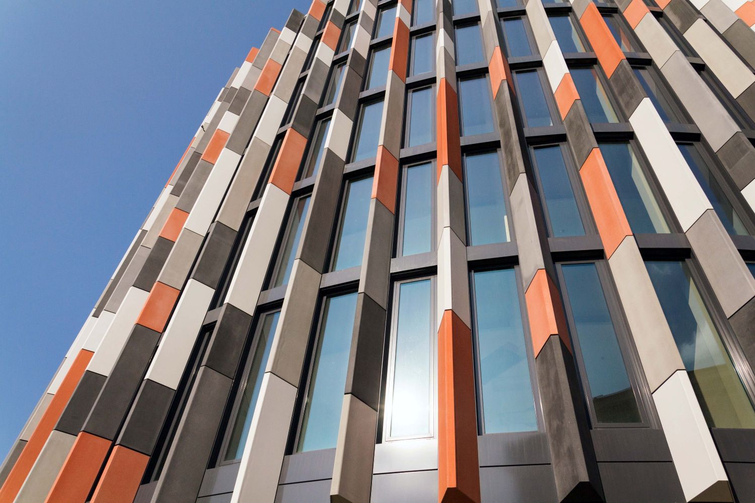

Façade planning needs to be moved upstream, with M&E being involved at RIBA Stage Two – not just as space planners but as performance drivers. This means using passive design strategies to reduce mechanical load before any kit is upsized.
(Image caption: example of a building with piers either side of the windows to create shading. Preferable to flat glazed facades)
For instance, brise soleils and vertical fins should be incorporated to reduce solar gain on glazed elevations, while openable windows with acoustic ventilation panels to support natural or hybrid cooling must also be a consideration.
Similarly, plant spaces must be located in positions that ventilate into low-impact façade zones, and not prime corners of the elevation, and envelope penetrations must be designed with integrated solutions, not just stuck-on louvres at the last minute.
